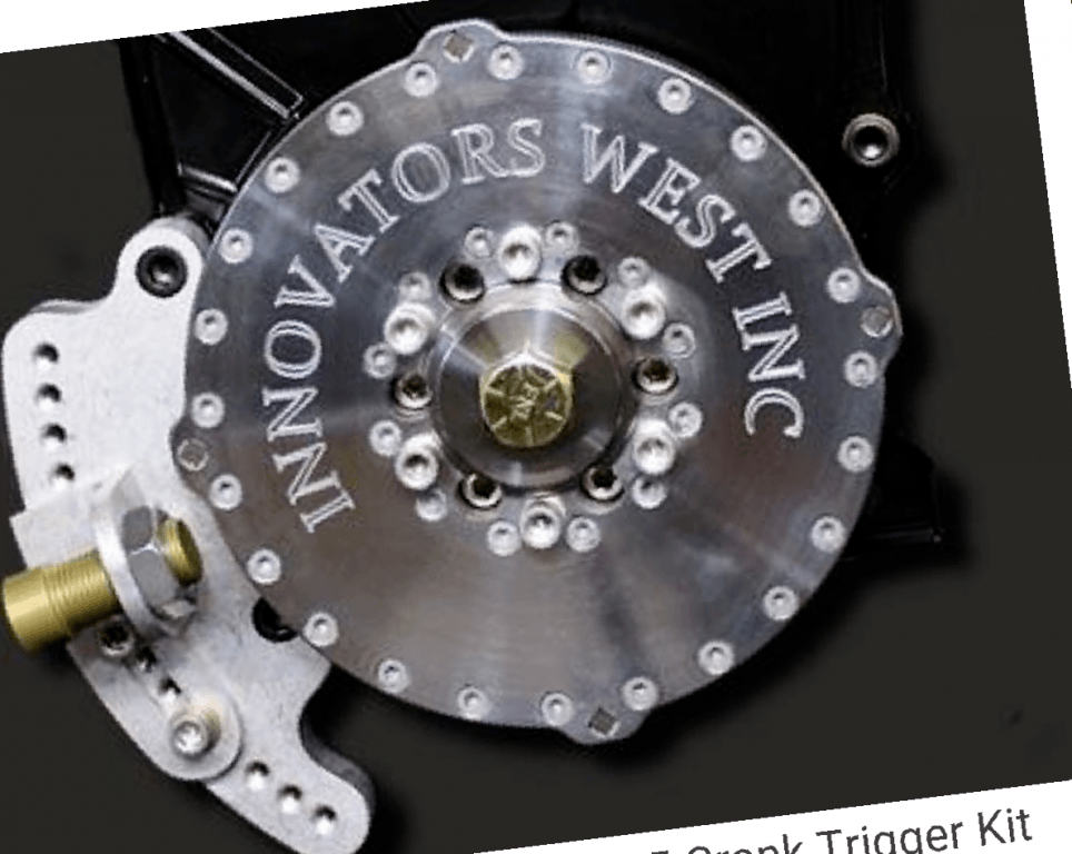

Anyone here use the Innovators West damper with crank trigger? Thinking about going in a different direction.
Couldnt see on the website but does anyone know if the damper has 360* timing marks?

As fancy as that dampner appears I just can not imagine it without 360° markings.
how big is your motor? if your motor is 500 " or more, inertia weight is important. i would really talk to your engine builder and get his input . i don't like the fact that you cant service (rebuild) the unit your self . ATI is the way to go. they have many option for our mopars. there race proven check out there website http://www.atiracing.com/products/dampers/charts/damchrysler.htm

Motor is stock stroke 440. That may change though.

I was interested in this because it has the integrated magnets for their crank trigger setup.
Just looking to see if anyone has run this setup.
You can get magnets on an ATI. They sell just the magnet shell for $250 for the mopar units if you already have an ATI. I've used the Innovators West on some SBF combos. I don't remember if it had timing marks all the way around.
