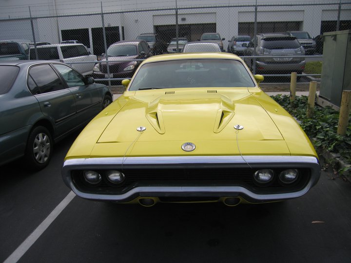

71 or 72 with 73 or 73 hood
the other way

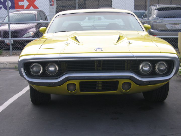

72 with 73 hood
