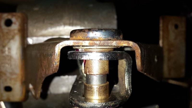

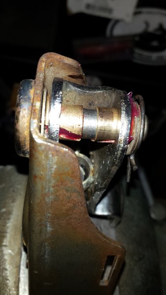

68 Coronet 440. Floor shifter. 727. At the main lower pivot point of the shifter, there are 2 plastic/nylon bushings. One of mine is disintegrated. Considerable amount of slop and twist. Looking for replacements but I'm unsure of the correct terminology, thus unable to find them. Any help would be much appreciated. Part numbers or vendors would be amazing.
You might be able to find a match here.
Dry-Running Flanged Sleeve Bearings​
I used door hinge brass bushings on mine. Had to open the holes a wee bit, but they work well.
The McMaster-Carr bushings are exactly what's in it right now. It crossed my mind to use hinge pin bushings and I'm glad to know that it's possible. Once again, you guys are life savers.
