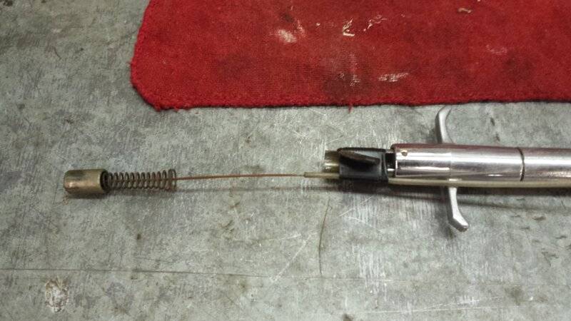

This is a pic of one, but it doesn't show the threads. I have black tape on them. Mine does unscrew. I would suggest wrapping the knob with a few rounds of heavy duct tape. (I highly recommend the Gorilla tape brand.) Then use the wrench if necessary...

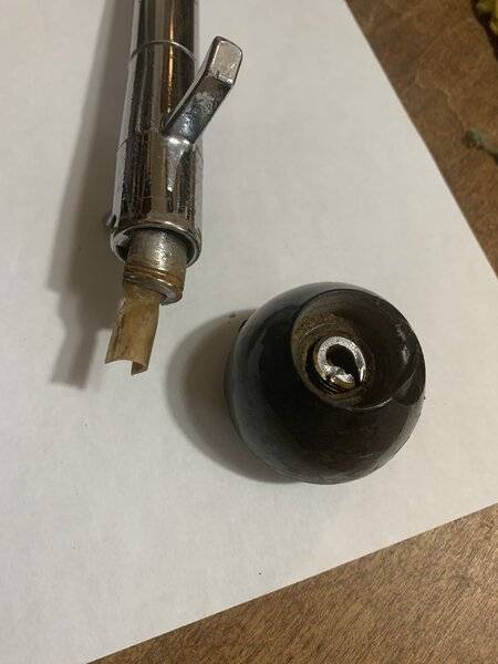

Well this happened, now got to find another handle

Be careful. Once you pull the reverse lockout off of the cable, it's about impossible to get it back in place. That's what happened to me. I couldn't get it back together. The pic I posted earlier is the original from my car, which I am keeping as a possible spare. And many years ago, it was easy to find used ones, so I just bought a whole handle and installed it.
