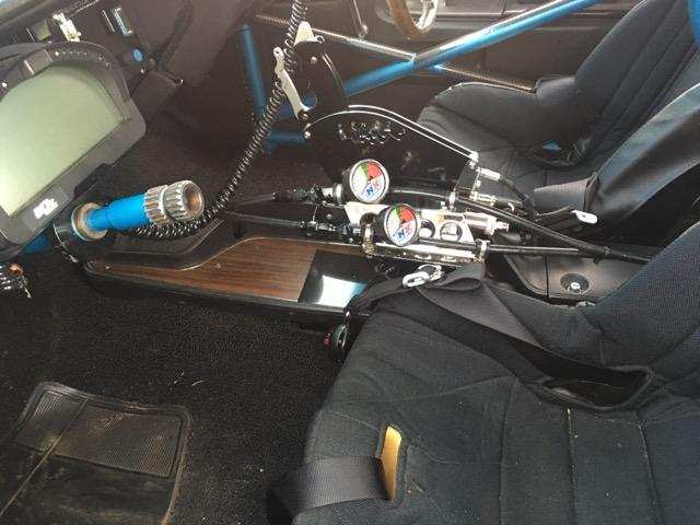

PPP with the air shifter! Is what I would do. I currently have a B&M Pro Ratchet which I'm very happy with, but the next step would be the PPP

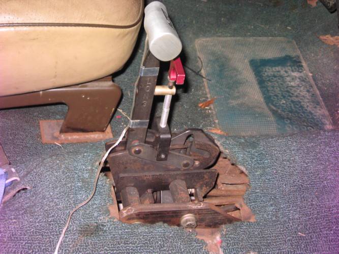

I had a cheetah in my 62 savoy. Bullet proof (likewise the winters) but not idiot-proof (me).
Too many 1-3-2-3 passes to suit me, so I modded the cheetah for a forward pattern glide, and put it in my Tina. Functioned perfectly in that application.

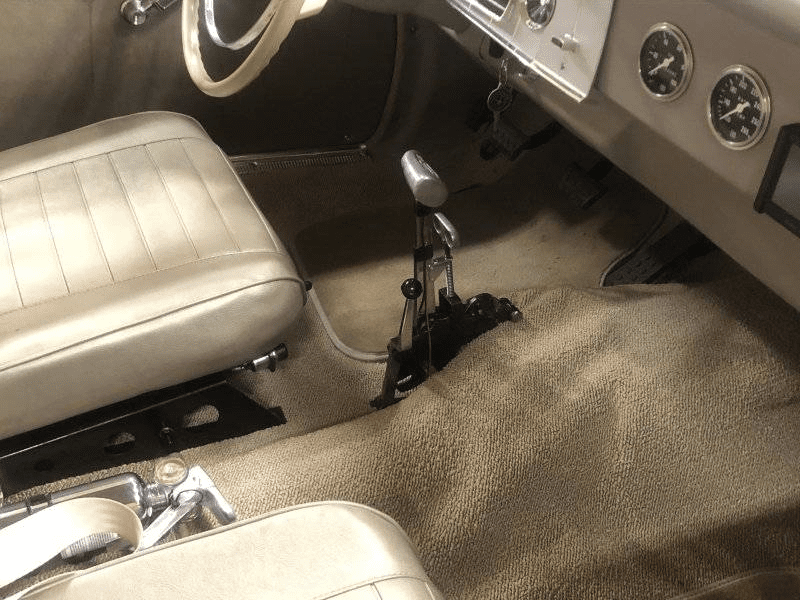

Put a B&M pro ratchet in the 62, love it, put another in my Opel.
The ratchet works with the forward pattern or reverse. I'll still be able to use it when I put in the reverse pattern transbrake trans.
Air shifter would be great on the strip, but I think a pia in a street car. Contrary opinions welcome, I've never tried one.
