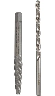

Get a small drill and an easy out bit......go very slow and use a tap handle to hold the easy out bit.
