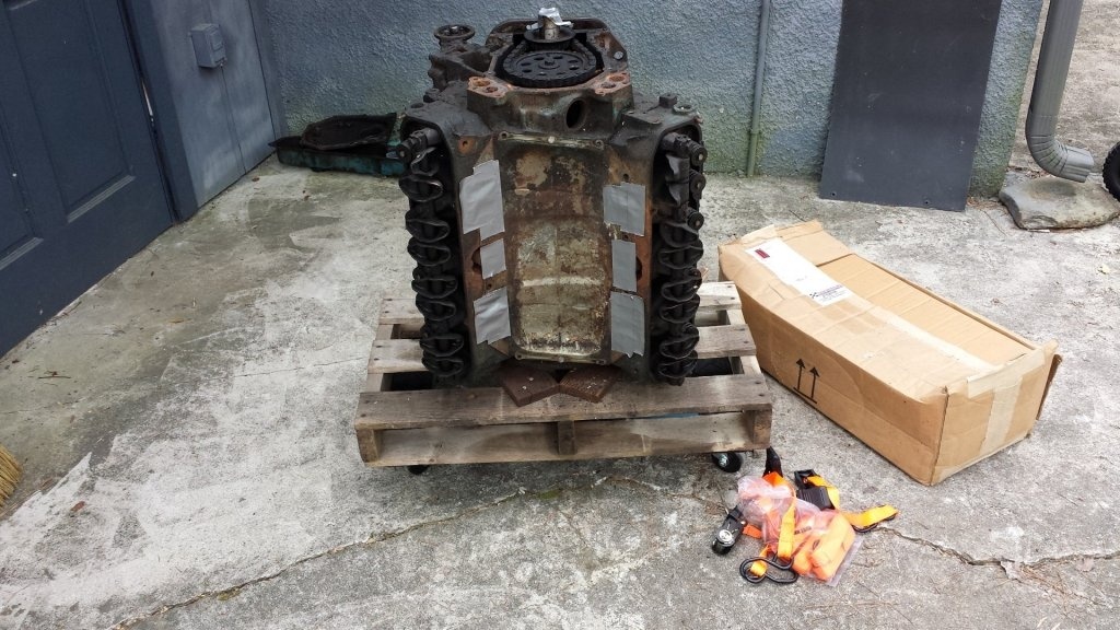

Last one I shipped I used 4 x 4 blocks(attached) in the center of a wood pallet. To protect the pan and strapped it to the pallet, made a frame and covered with cardboard.

Either way. Standing on the end is the way my engine builder ships them back.
Except on a better pallet than mine.
I used what I had. Makes the footprint smaller.

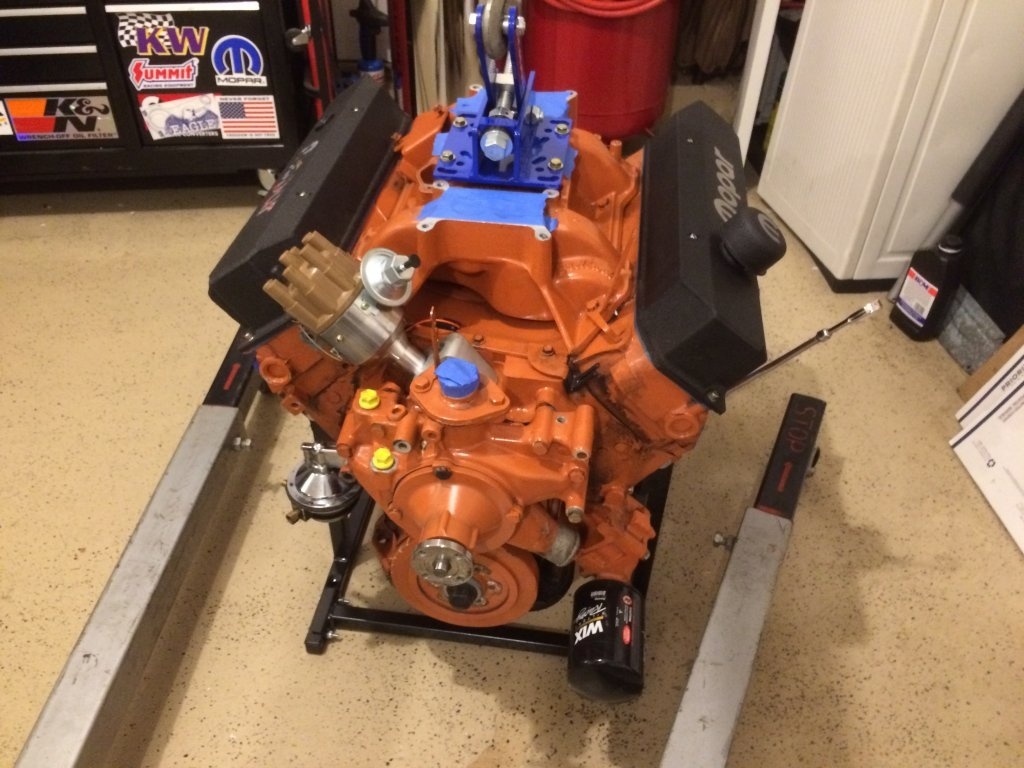

Will have to have Fastenal LTL come to my house and pick it up. And the motor will have to be shipped on its engine cradle.

I use a std 48x48 pallet and bolt it down supported under the pan rails. Then I box it up using 1/4" plywood and 2x3s. I don't like to leave a anything identifying it as an engine and I want it to be easy to grab with a pallet jack or forklift. Last time I ship using Forward Air and they were great. I haven't heard of shipping through Fastenall but that would be a good option too.
Yea, I need to get that engine cradle bolted to the pallet. Got plenty of plywood and 2x4s that have been looking for a project. In talks now with Jim about shipping and stuff.
