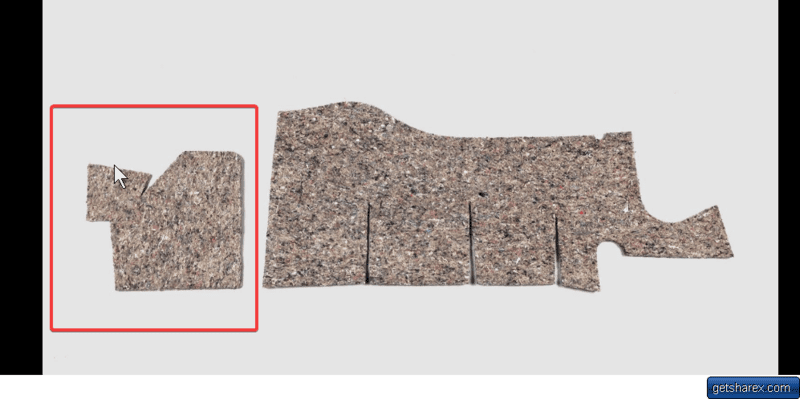

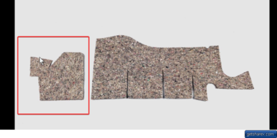

i am in process of installing the shoddy pad. ive installed the right side but im not sure how the left side installs?
attached is a picture that i marked off.
i have a vent on the left side so im guessing i need to modify it?
anyone have similar issue?

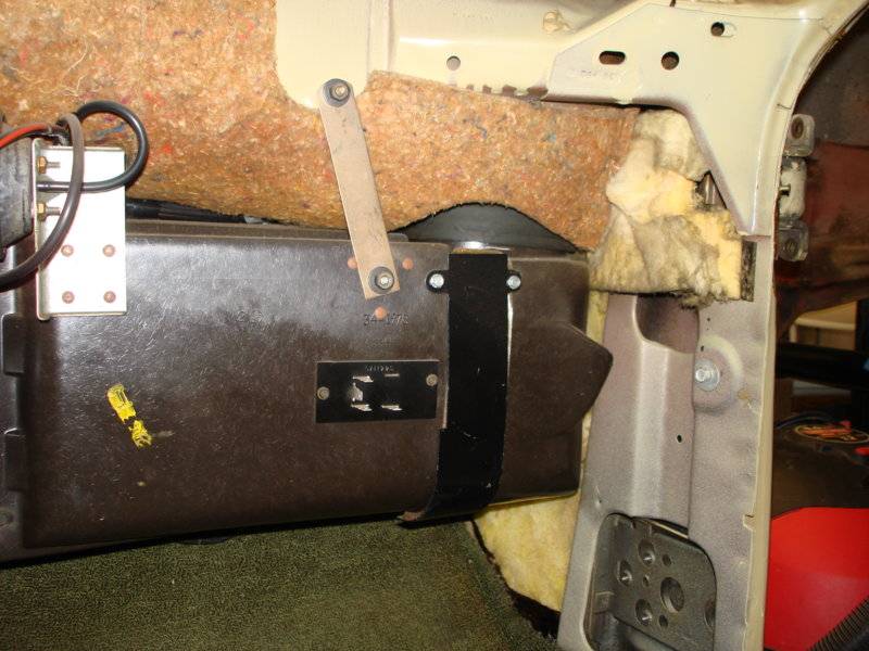

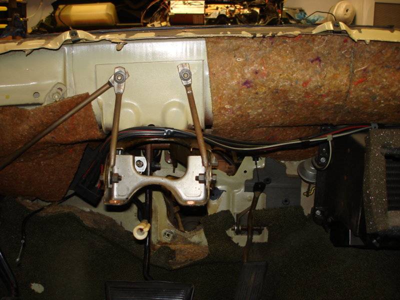

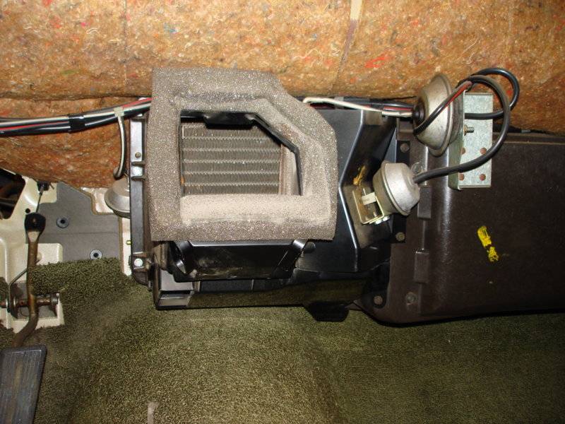

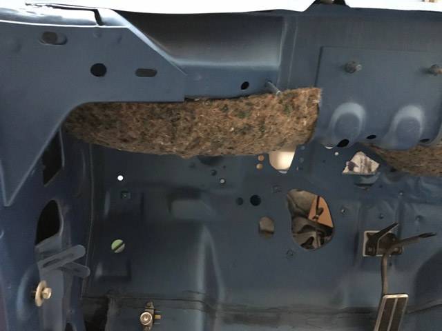

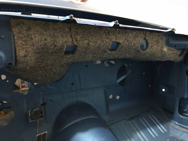

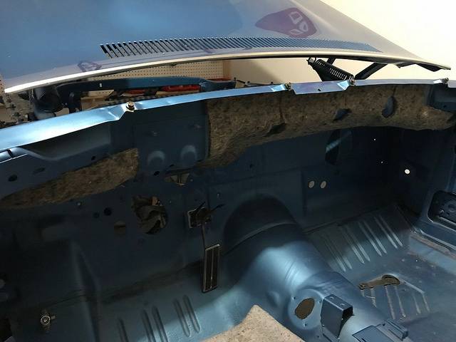

Here is mine from my 72 AC car, spent a lot of hours and searching trying to figure it out. Not sure if this helps.

Looks good thank for the pics.
I wish I had that support bracket for my heater box. It sags a.bit. Is yours AC? Maybe that's why. My. Firewall was replaced and the metal is thinner.

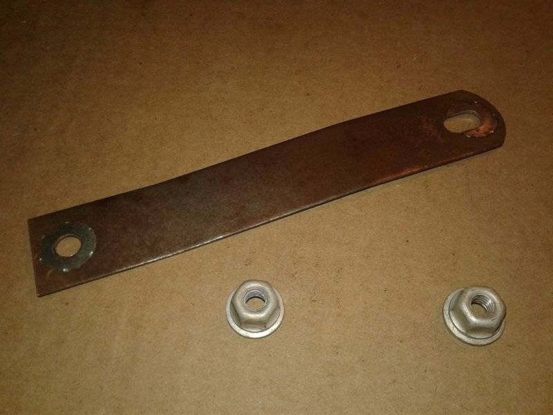

I have that bracket with the OEM nuts (see pic below). Removed from a 1973 Plymouth Satellite.
$20.00 + shipping for all 3 pieces.
I would take it but my box doesn't have the spot fasten it to. Not all cars have the bracket I think it's for AC cars.

Okay thanks. To tell you the truth I don't think I've ever seen a 1971-74 B Body NON A/C heater box. Every 71-74 B Body I've owned or parted out had A/C. 1966-70 B Body different story, I've seen both.
