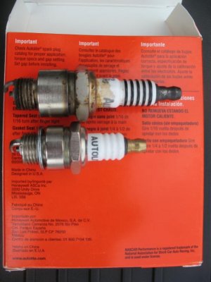

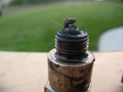

Took out the autolite AR 72 today and replaced with Autolite 2974 short plugs.
When I removed the plugs for cylinders 5 and 7 on the driver's side they appeared to be fouled. I hope they are gas fouled and not oil fouled.
The car has a Holley 800 cfm (4780C) that seems to run on the rich side.
The car starts right up. But if I hit the gas pedal real fast it almost stalls out.
When I started it up with the new plugs and drove it, I failed to notice ary real difference in performance.
What shoudl I look at next?

Please be sure that the wires going to those 2 plugs haven't been damaged by heat from the headers. If they aren't firing properly, they'll certainly foul. Fouling from a rich mixture usually looks dry & sooty. Based on the appearance of these plugs, I don't think the problem with #5 & 7 is because the engine is running too rich. Those plugs look more oil fouled to me. Because they are adjacent cylinders, it's possible that you might have an intake manifold leak on the valley side. If this happens, the engine can suck oil from the valley. I've had this happen on a couple of BB engines. Have you replaced the intake manifold recently? It looks like a new aluminum one. If so, did you put sealant around the intake manifold ports, or did you use paper gaskets on each side of the valley gasket? Were the surface of the heads milled without milling the intake manifold surfaces? If they were, it can create a poor sealing surface in the valley area because the intake manifold will sit higher on the heads.
Other things that can cause oil fouling include worn valve guides, defective valve stem seals, and worn/bad oil control piston rings.
I'm curious to hear some other opinions, but I'll have to read them a week from now. Good luck!
That's oil fouling caused starting and cutting off over and over with out bringing it to full and not giving it time to burn away valve stem drip oil. Nothing wrong with your engine. To stop the problem stop starting it and cutting it right back off.
