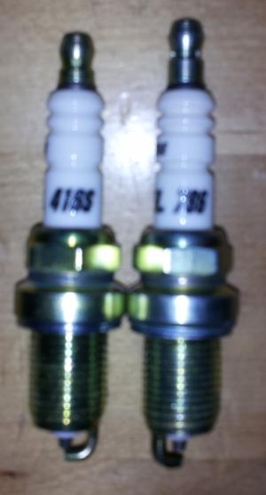

I've got a 440 with Edelbrock 84cc heads and a set of headman headers that came off of the 383 I replaced. The 383 plugs had a 3/8" reach inside the head, but the Edelbrocks require a 3/4" reach inside. This makes the plug longer, and I have to remove the header to get #6 plug installed.
I am using a set of Accel 786 plugs for the other 7 holes and an Accel 416S plug for the number 6. My supplier tells me the 416s is the "shorty" (thus the S) but there does not appear to be much difference in length.
Anyone out there figured out which brands or models are shorter than others ? Is there a true "shorty" plug ?

I can see the difference between the two plugs in your pic. The thing I would be worried about would be the "heat range" between the two. The depth of the electrode into the head is important. You don't want that to be too short. Any chance of modifying the header at that plug? (Hammer and a round punch)
