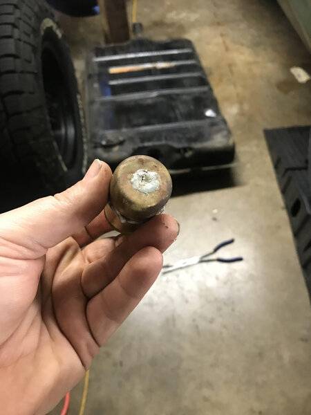

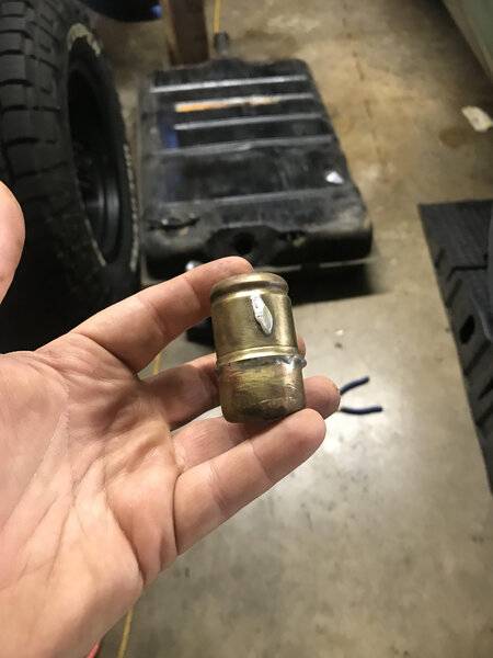

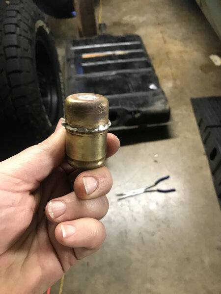

This is the ONLY part keeping my fuel gauge from showing something and I found a crack in the float, so I used my mini butane torch and some electrical solder and filled the crack, re-soldered the seams, then tested it in a cup of water by holding it at the bottom and no bubbles.
My repair is ugly and I'm not exactly proud of it, but I am concerned about the longevity of the repair. I've got a new Spectra fuel sending unit that'll be delivered tomorrow and I'm contemplating on whether or not I should use it, rob the float from it, or just send what I've got which is a replacement fuel sending unit I purchased back in the mid 2000's.
I ohm'd out the sending unit and the range is correct per the FSM, even tough I suspect it'll drop from showing full to 1/2 at twice the rate of 1/2 to Empty which I'll deal with I guess.

You can buy just the floats, so maybe use the new, and order a float ?

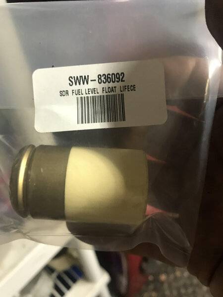

as much as I wanted to do some burnouts this afternoon....I ordered a few stewart Warner 836092 floats from Summit (that'll be here tomorrow).
Submerged it in a cup of water overnight and see if it takes on any water. I don't think you have anything to lose at this point.
Water is denser than gasoline.

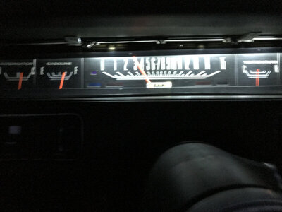

Summit got the Stewart Warner Lifecell's I ordered faster than Amazon gets stuff to me these days, and today I got the tank re-installed using the same sending unit (the new one I ordered from RockAuto is MIA with Fedex). Everything works...kinda....the when I Ohm'd out the sending unit, it had a range of 12-77 which I figured would be close enough, but after filling up the tank I only get 3/4 tank of fuel, which is Ok, at least I have something. But with 7 gallons in it the gauge red E (Photo's blurry due to driving while trying to take it)....
