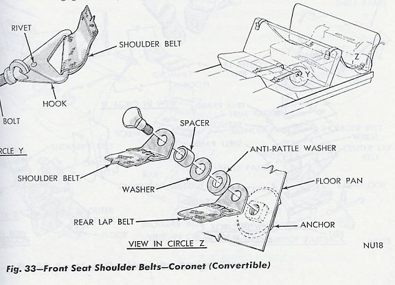

Really? I took a look at the 1969 service manual and it had a diagram of a belt with a rod through it at the end and a series of gaskets and clips and plates to dress the opening through the package tray. Just checking but was the Charger available with this option?
I think you are speaking of the REAR should belt option, which attached as you are speaking of. The convert. FRONT belts attach through the rear package shelf also because they have no roof to attach to as the hardtops do.

Yes, i did misunderstand that, however again ALL B body shoulder belt applications are the same for hardtops and converts. In other words, if it is a hardtop the front belts attach to the roof. If they are rear belts they go into the package shelf. If it is a convert they also go into the package shelf. And before you ask, i don't know if you ordered fronts anf rears on a convert. but i would suspect that the went into the package shelf side by side with the rearsw inboard.
