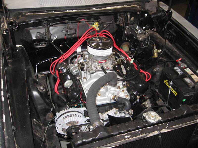

The 69 RR drum brake master is fine.
I run one in my 63 bomber with line lock.
