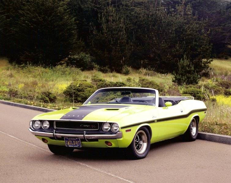

Sublime is never going to show depth like a darker color... But if you look at the reflection of the curb in the quarter panel & door, that's about as good as it gets... Single stage Centari, rolled into the booth & layed down three coats, cut & buffed a few days later...
Looks gorgeous. I saw a 74 charger (albeit not my favorite B-Body) once in sublime green and fell in love with the color.
