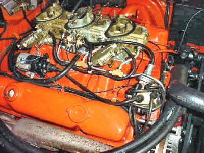

I have a 1970 GTX 440 six barrel and an air grabber hood and want to use phenolic spacers to eliminate some of the heat to my carbs because I think I have a bit of a heat soak problem (it starts perfectly when cold and when it's hot if I restart right away but when it's hot and sitting for a while 10 to 30 minutes I need to crank it for 5 or more seconds before it starts).
I see them the spacers available in ¼ or ½ inch thick and I am wondering how thick can I go without any problems with the air grabber setup.
Also what needs to be done with the choke rod to make it longer?
I don’t see any other concerns but let me know if there are any.
No heat soak here,starts instantly hot or cold,check your float level.As for the choke,all you can do is make a new rod and add the thickness of the spacer to the length.

that will help with heat soak problem, but "I think" anymore than 1/4" spacer you will run into "hood clearance problems" @ the seal area on the air cleaner base to the N96 Air Grabber plastic plenum/upper portion mounted to the underside of the hood... the rubber will only smash so much, before it becomes an issue...
