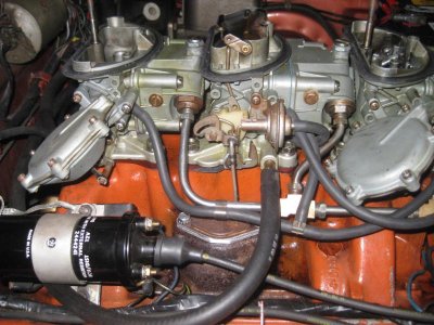

Last summer I was having some heat soak issues, probably due to the moonshine in the gas these days, so I installed some 1\4 inch phenolic carb spacers and it seemed to work (we'll see next summer).

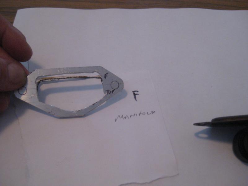

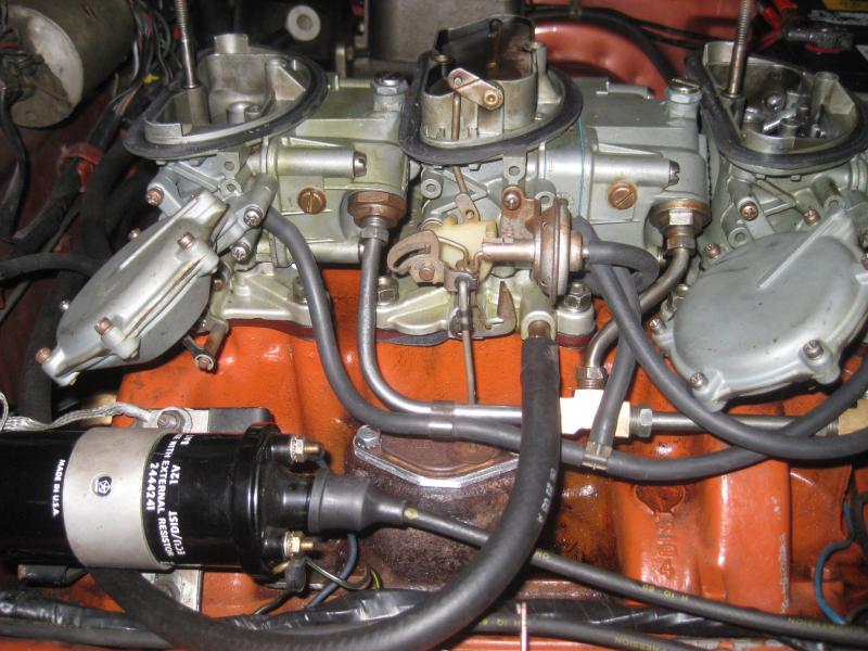

Problem is the divorced choke rod is not quite long enough to close off the choke and instead of modifying the rod like some have done (my choke is orig and I'm not going to alter it in any way) I decided to make up some spacers for it.
Now the geometry is correct and it works like it should.
Don't laugh, I am not a fab guy and I did this in my shed at 10 degrees today but it works like a charm.

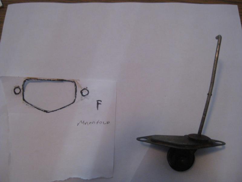

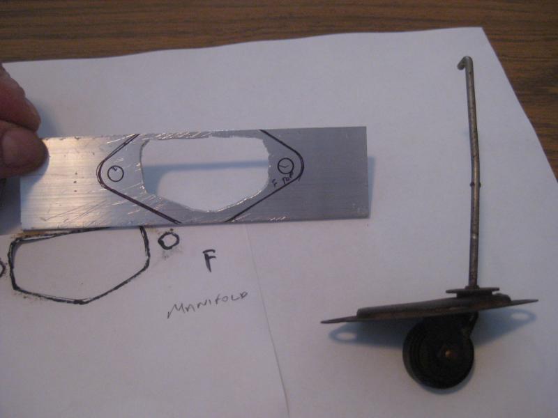

I used 1/8 x 1.5 inch alum stock from home depot and made 2 pc. to get my 1/4 inch, made pattern from choke well for inside then slipped the choke through and marked the outside.
Surprised that they don't sell them with the carb spacers.

Got got them off e bay with new longer studs included, I wanted to go thicker but couldn't because of the air grabber setup.
