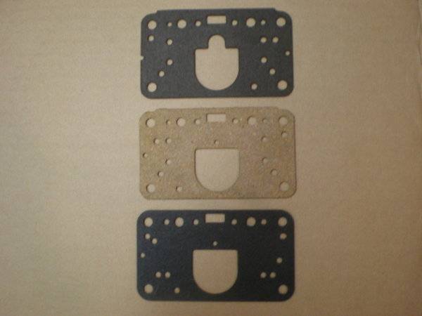

Personally, I use only Holley kits and use the blue gaskets (vs the brown colored or corprene material) and alcohol based accelerator pump diaphragm material...the green elastomer. I also use only the white plastic fuel bowl screw seals. I generally have at least 3 complete kits on hand at all times. As an alternate, Standard Hi Grade jiffy kits are a good substitute. Most of the other kits use a totally different in let valve adjustment arrangement....basically just the reverse of the Holley design.

I always had to change out the brown sticky gaskets every other year.

The black gaskets are as good as the blue if you can find them,I buy them in bulk,not easy to find.
