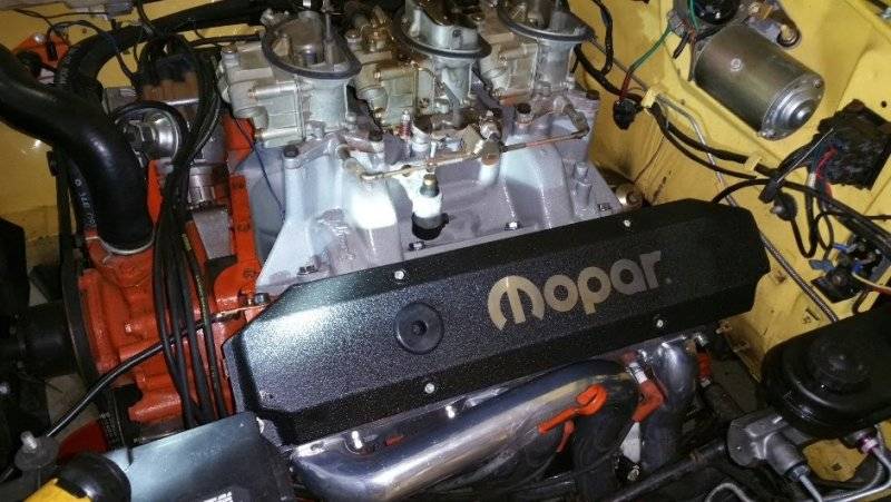

I have a 1970 gtx w 6 pack the linkage for the out board carburetors has come off at the center carb does anyone have a picture of this linkage? I need to understand how it should be reassembled . Thanks in advance.
Here's some I found of my 6BBL linkage (driver's side). Hope this helps!
