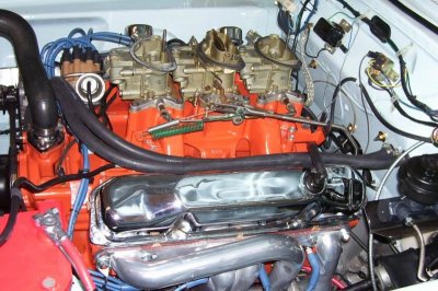

i've been messing with six paks since 1970 and the best advice i can give is "don't try to re-engineer them". they don't need much more than richening the idle circuts and main metering in the center carb. i don't use any special gadgets or parts. i don't try to modify the vacuum system for the end carbs, just some spring changes as needed. no big accelerator pumps or squirters, no big jets.
