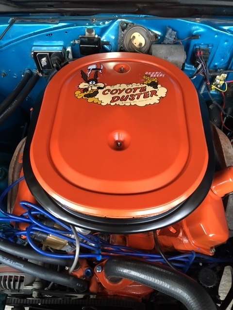

like Bill said, they can be a pain in the *** to tune and look cool, but when they are tuned they work good. But for the cost and problems you can have tuning them, it is a decision you will have to make. I finnaly had to have the car tuned by a professional and he used a dyno to help get it tuned correct. It is all about the $$, and how much you really want it.

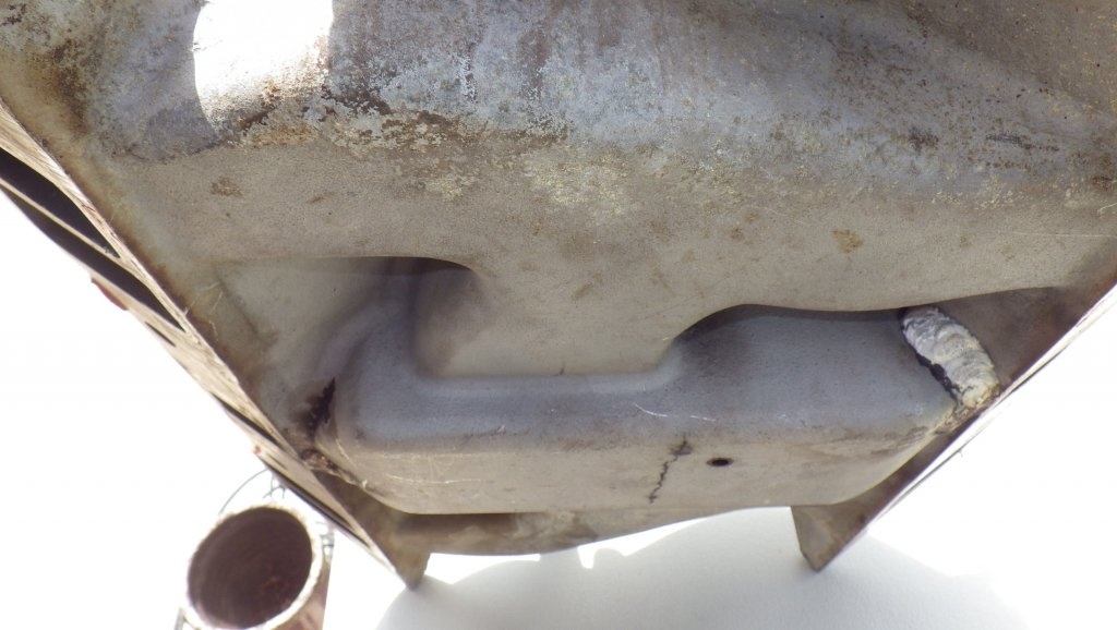

The 'ole CH4B shown......looks like someone "welded" an intake runner to the bottom flange... i use the term welded optimistically because it appears that the person that "welded" it just graduated from weld school and used a stick electrode without any surface prep or shield gas. It appears that filler metal is just gobbed on without any penetration. Aluminum should be welded using the TIG Heliarc ptocess with helium as the shield gas and depending on the section depth, preheat maintaining interpass temp followed by post heat and cool down, using a filler metal compatible with the base metal alloy. A popular die casting alloy is 380Z, and is easily repaired using correct procedures. I'm sure others will disagree or have their own opinions.
