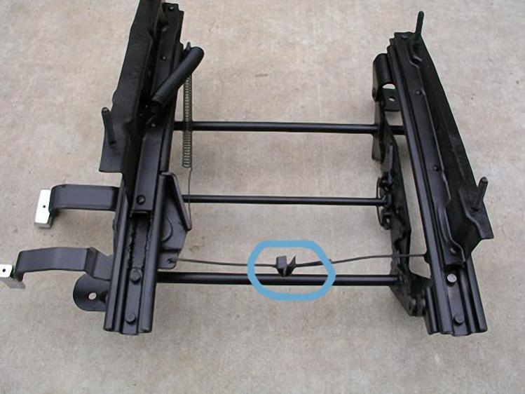

I need the clip that holds the two small rods together for the front to back sliding movement.
Can't locate one online and parts store has no clue.
Its for a 1970 GTX and I am not even sure what the correct name for it is.
Thanks in advance for any help

Looks like something you will need to fab in the garage. You can even get a piece of 8-32 all thread, cut it in half and attach it to each lever then use a coupling nut in the middle for adjustment.
