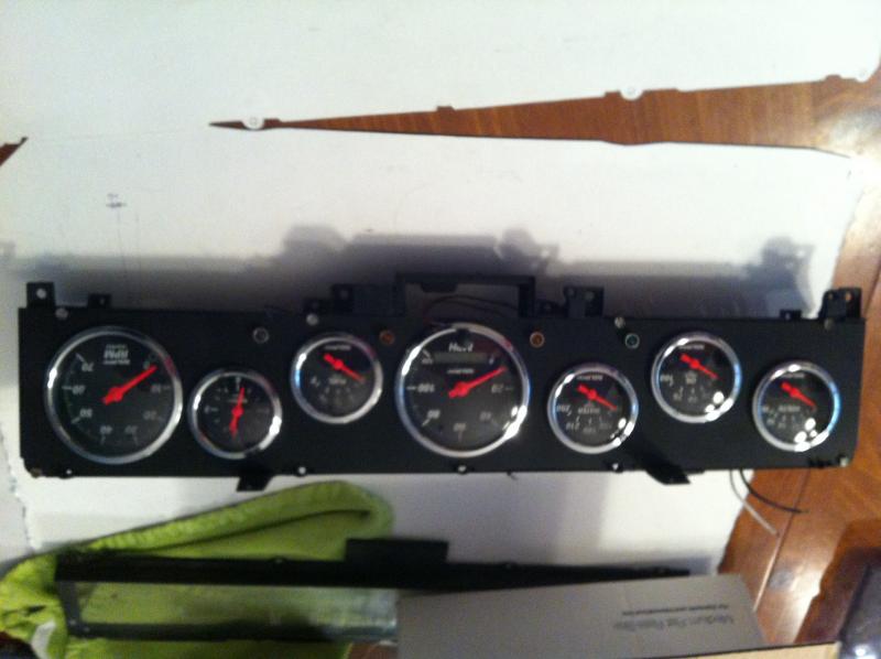

What are you looking to do? I custom fabricated a plate to mount to the front of my cluster, then cut holes to mount circular gauges. I'll have to go back and look but the problem is the rectangular RR guage bezel. If you want to keep it, I believe you have to use 2-1/16 gauges. If you ditch it, you can fit 2-3/14 tach and speedo if you get crafty with the placement.
