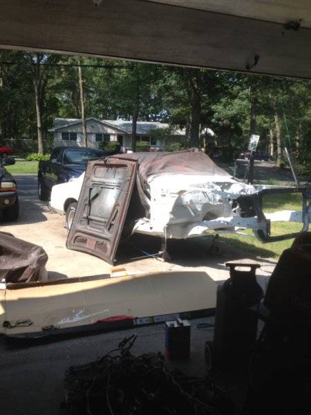

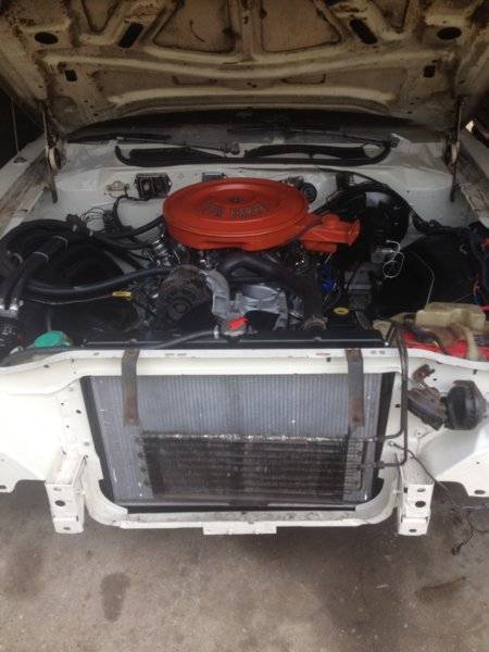

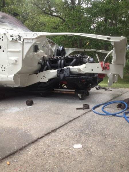

I’ve done a K removal. I had to, long story for another day. But when it came time to reinstall the engine and trans, it was easy.
Set your stuff up prior to re assembly and have a good go at it. Below, is where I started (and completely prepped to go...) and where I ended later that same day.
I started at butt crack:30 in the morning and finished by dinner @ 6:00pm. Drove it into the garage. This was a simpler LA to Magnum swap.
(Ahhhh, love the long summer days to get stuff done.)
Wow, that was a productive day!

Yes! Worked hard at it. Then again, I was a healthier and a slight bit younger. Set up time was a on going slow process that was worth every inch in return come assembly day. There was no rush, so, why not relax and set it up.
