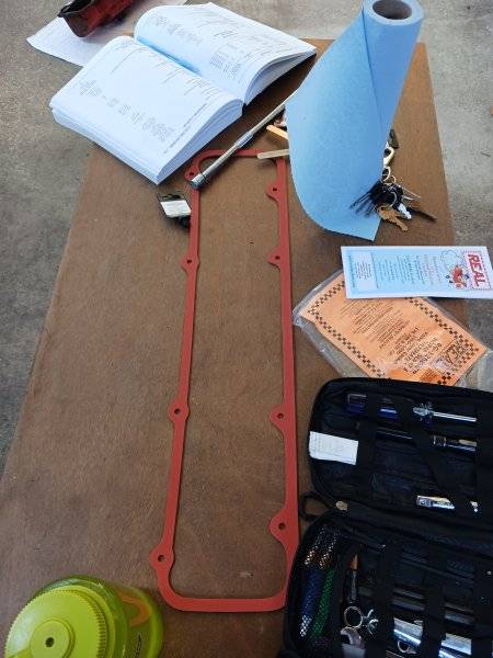

Slant 6 Valve Cover Gasket Opinion
I never had problems with the old cork or rubber if the cover was straight and installed correctly
Looks reusible. Go for it ! Then give us a review.
Hello All. Gasket in looks pretty good!

I have never liked silicone for 'oil related' gaskets. Silicone seems to swell from oil and is then unusable.

In regards to the gasket I had an issue. The instructions says explicitly 40lbs of torque to fit the valve cover back on. Used a torque wrench and tried tighting up the screws to that specification after 1st run and broke off the head of two screws. 40lbs is wayyy too tight. It was beginning to bend the cover upon closer inspection.
Well after I get done crying and swearing I am off to harbor freight to get a screw removal kit...
If you get these Tennessee gasket do not follow the torque settings!
Thanks for the info about MMO, I will try that.
You must be a very novice mechanic. Its 40 Inch pounds most likely. Common sense tells a guy 1/4 inch is not going to like 40 foot pounds. Now you made a easy fix a disaster.
