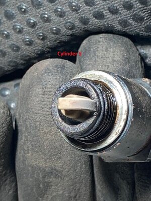

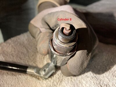

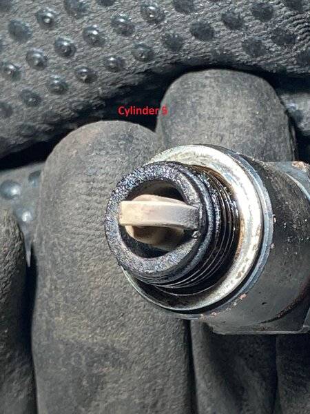

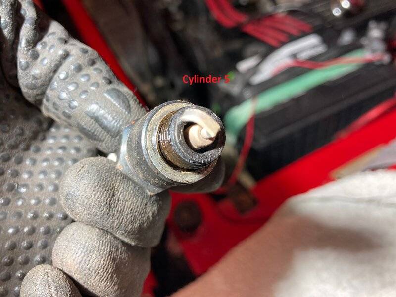

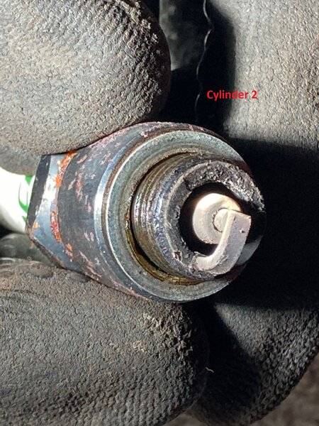

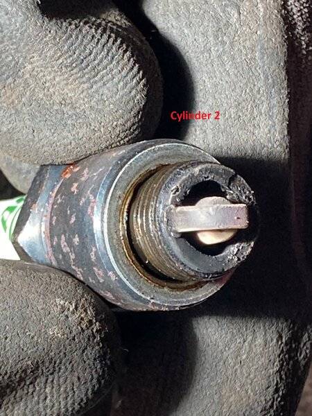

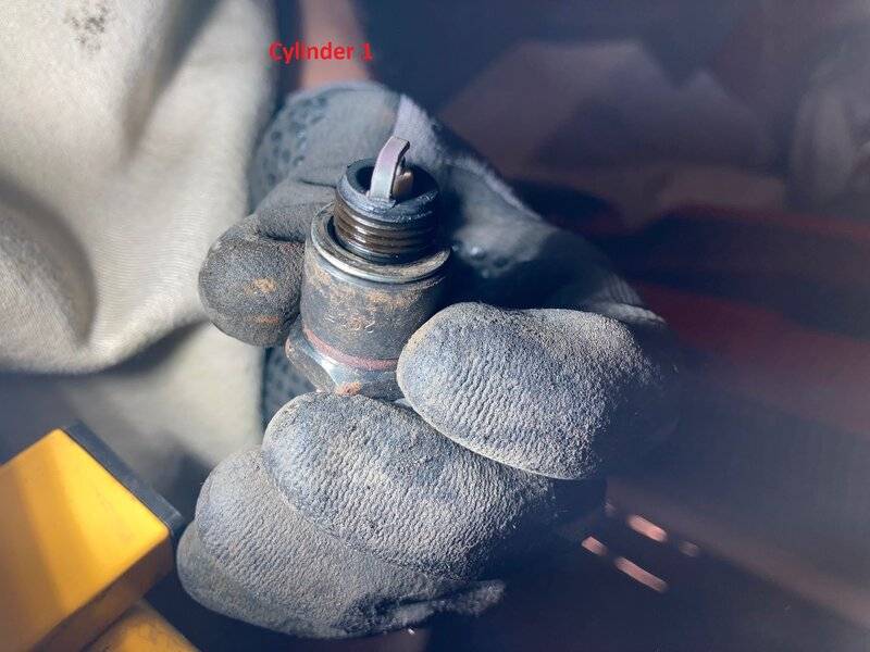

I would hold off on the pump for now. Change your oil, don't warm up, take long enough trips to get the temp up and check your spark plugs. I think its a combination of your short warm-ups, choke and could be running a bit rich.
I have posted some pictures of the spark plugs I pulled after the last trip above. However, being a newcomer I am not that confident in my plug-reading
