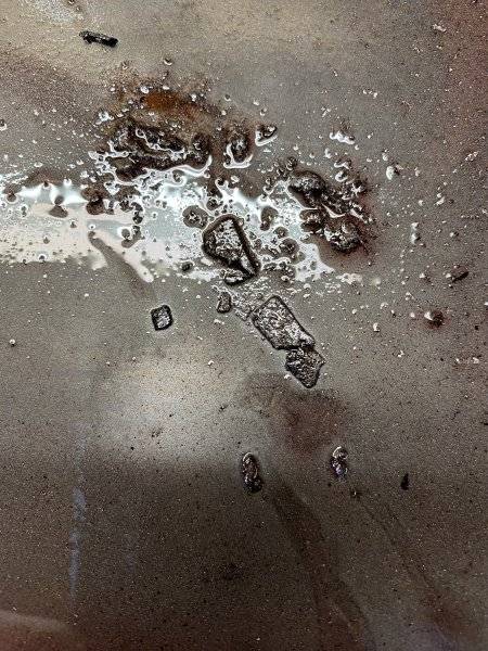

Dropped the pan today and don’t like what I see. Fluid is dark and full of flakes. Looks like metallic burgundy paint… a film of metal particles in the pan and some larger chunks… and this just after last summer on the fluid. Letting it drip tonight and I’ll look closer tomorrow but not promising…
Anyone care to guess what these metal pieces are from. They are about 1/4” wide.
It's bad! Wild guess hard to see overrunning clutch? What is that white puke.
Will they pick up with a magnet? Almost looks like friction material. Or seal material. Thin magnetic material could be overrun clutch springs. Has the trans ever been rebuilt? Time to pull it down and go through it.
How loose is the low/reverse servo apply?
That’s just light reflection In the pan. I adjusted the rear band. It did torque up but there were only a few threads left on the adjuster at torque spec. After seeing this crap in the pan and fluid she’s heading for a full rebuild.
