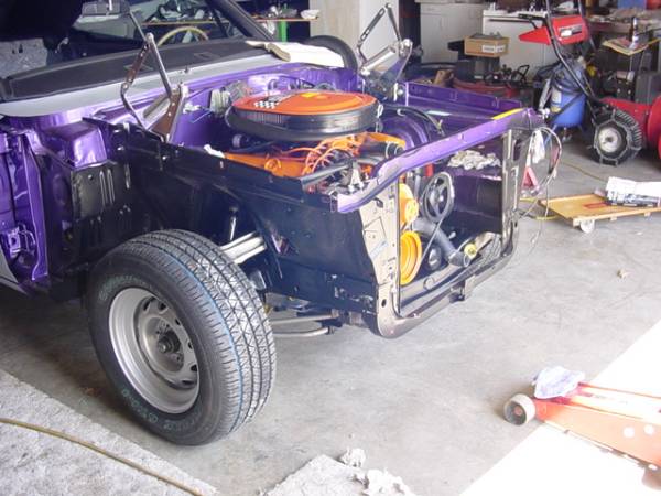

Got my 70 Charger R/T finished and put on about 185 miles. Steering is power with everything (and i mean everything ) new or rebuilt. Front end was aligned and everything is tight. New Goodyear Eagle GT+4`s. 15x7 ralleye rims that were speed balanced bare and are true. Still this feels like it`s completely worn out & sloppy !! :confused: Anyone got any ideas??

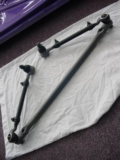

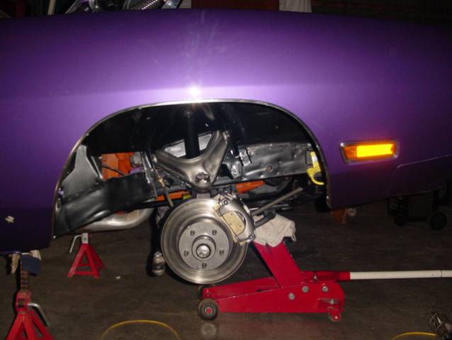

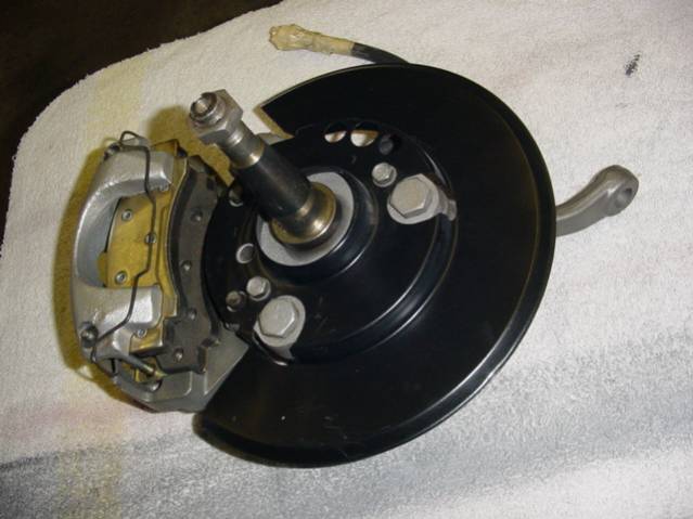

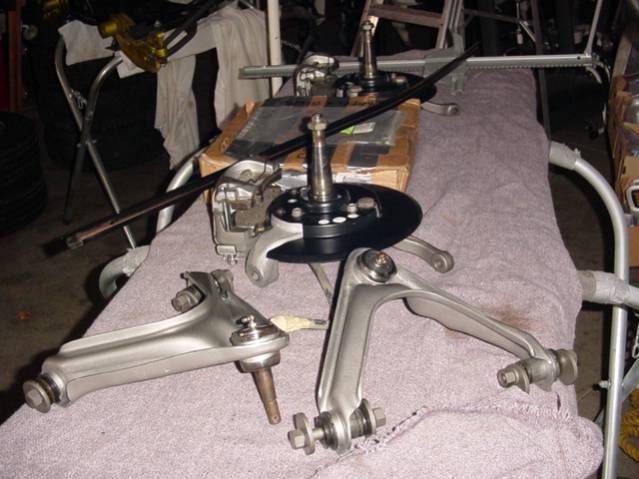

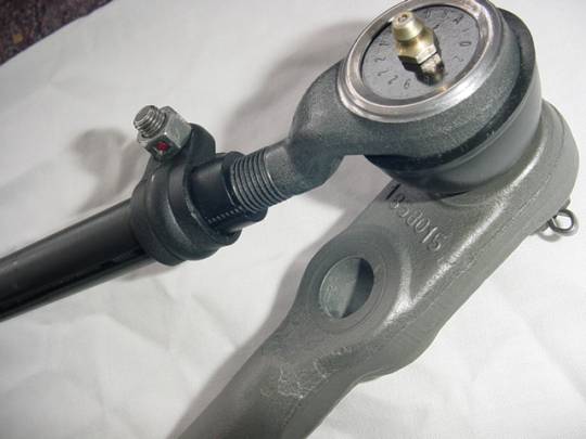

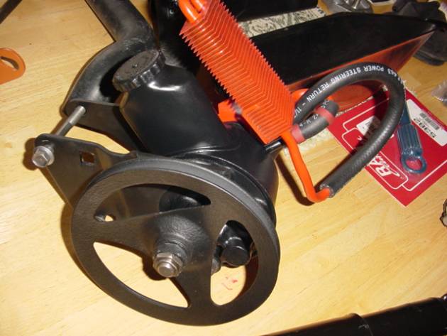

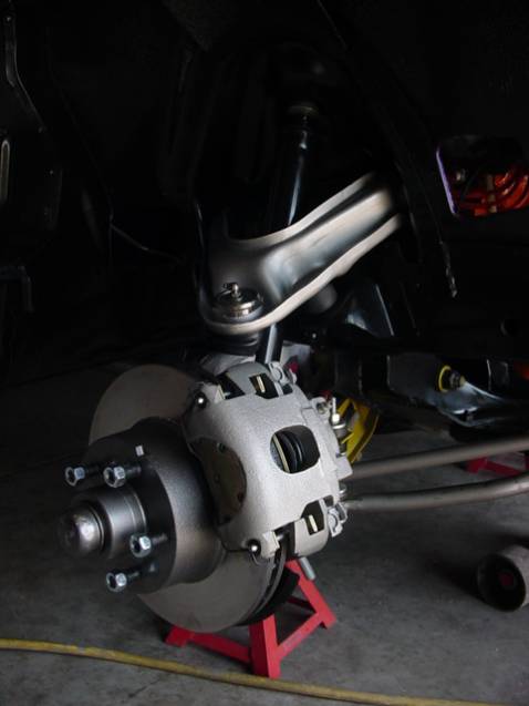

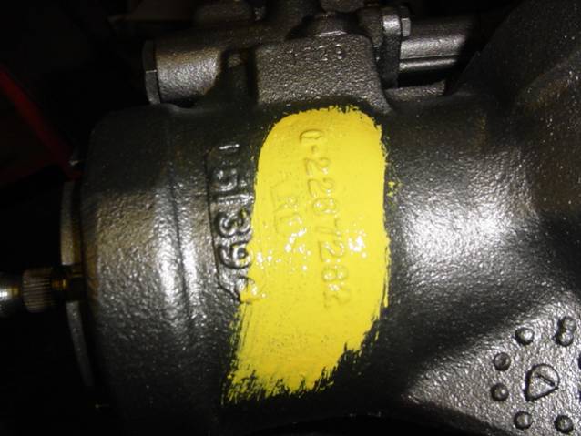

Thanks Everyone, :yes: for all the comments & suggestions. Here`s a little more food for thought. I had the power steering gear box & pump rebuilt then i detailed them + i personally installed these & the following, new steering knuckle on the coloumn, new pitman arm, new idler arm,new inner & outer tie rods,new upper & lower ball joints,new upper & lower control arm bushings,new strut bar bushings,new stabilizer bar links,new inner & outer wheel bearings,new rotors,mint original spindels,new preformance torsion bars, new Goodyear Eagle GT+4 radial tires. I had the car certified for safety & the front end aligned to a 1975 Fifth Avenue as we couldn`t go back to 70 in the book. ( i was told that these dimensions were compatible.)
I had a 70 Runner (21 years ago ) that i don`t remember steering like this. It`s almost scary, but i`ve been driving for 35 years. I`ve got north of 70 in this now & REALLY don`t want to pile it!! :no:
( Maybe i`m just not used to all this power from the steering & the 440 +6, as i have been know to drive the odd Chevy & Ford in the last 20 years :rolling:)
I was thinking :edgy: maybe i`ll take this to another larger Mopar dealership were i can be with my baby while she`s on the rack, to get that front end alignment carefully checked again???

If the cars steering is rebuilt original with a "real" rebuilt gear box the steering should not be sloppy but rather super light with no real "feel of the road." That is the way the 100% power steering is designed to feel. You should be able to turn the steering wheel from lock to lock with one finger with the cars standing still.
