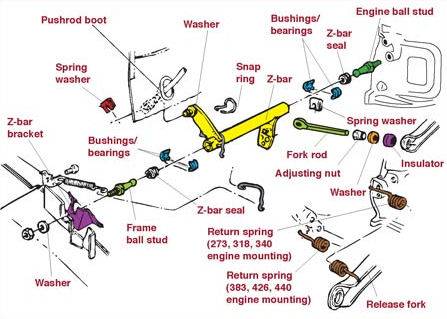

Bell housing/inspection plate
Flywheel
Z bar and brackets
Shifter
