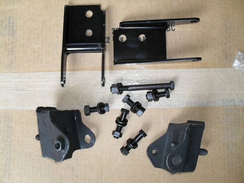

I'm getting ready to start the project. Patient is a 71 satellite that has a factory 318. I know that I need to change the motor mounts. But which are the best? I've looked at several on line and a lot of them look different from each other. Please share what you know.
Did this a while back. The 71 Plymouth Satellite I did it in used the older style mounts and not the spool type. I think those came in later. This is what was used in the 71
I did my 67 last year and here's the list.. Motor mounts , transmission , and depending on what transmission is in the car add a driveshaft and cooler lines possible radiator upgrade, if you are using power steering another pump or least the mounting brackets and I had to modify my throttle cable... Good luck with the switch.... Don't forget about the exhaust
