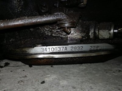

Is this a A904 gearbox? Picture added
Artis start off with an A998- A999 core
much stronger internal parts and a double wrap reverse band
