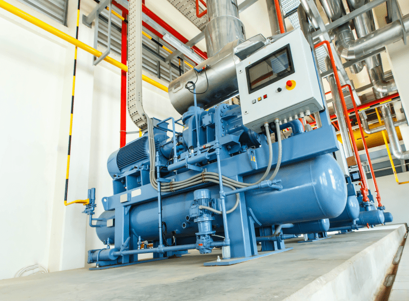

Blow it out with something like this...
Not like the one in your shop... :poke:
