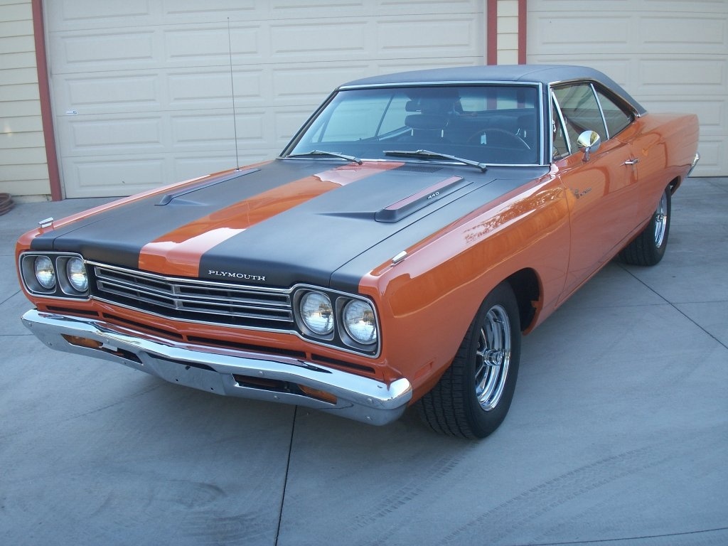

Small puff of smoke from heater control panel above the radio when I turned the key to the on position, had not started the engine yet, this is a 69 Road Runner, has anyone ever experienced anything like this? Scared the hell out of me, the smoke only lasted a few seconds & everything seems to be working OK
I looked in both the shop manual and owners' manual. That shouldn't have happened.
However, you have a nice looking road runner!
