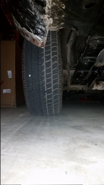

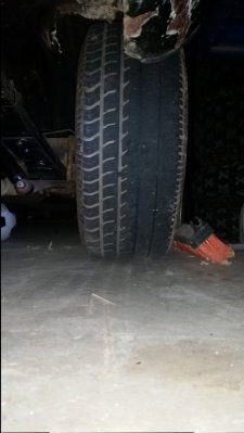

Ok so the bad news #1 .... i had relatively new tires on it before I drove it. when I got back the rear tires where completely bald only on the outboard side of the tire. The inboard side still had tread. When I looked at it from the rear it almost seems as if the rear tires have a positive camber and are pigeon toed. I know the bald tires arent from the burnout because it's not a posi and I only did it once ( bad news #2 lol) but my only guess is that the 8 3/4 rear end housing is bent from whenever it was hit. I don't know what else it could be. But I was wondering if any other rear ends ( A, E, body or dodge truck) will fit. I can get a housing cheap right now from a barracuda. Not sure if that will work though.

So this is what the tread looks like in the rear. Its kind of disheartening because if it's not the axle then it means the rear frame rails are bent. Like I'm hoping it's just the housing but I don't know. If the frame rails are bent would it even be worth it or feasible to build the car? I'm trying not to get discouraged but when it comes to the structure of a car being damaged I feel like it's a little over my head.

I should also mention that it was hit pretty hard on the left side and I can see oblong holes all over the frame from where it was straightened on a rack

This is why 'frame shops' exist. Take it to one and they can diagnose the problem. Ones that have been around for a long time can also straighten the housing if that's the problem. Don't get discouraged...
