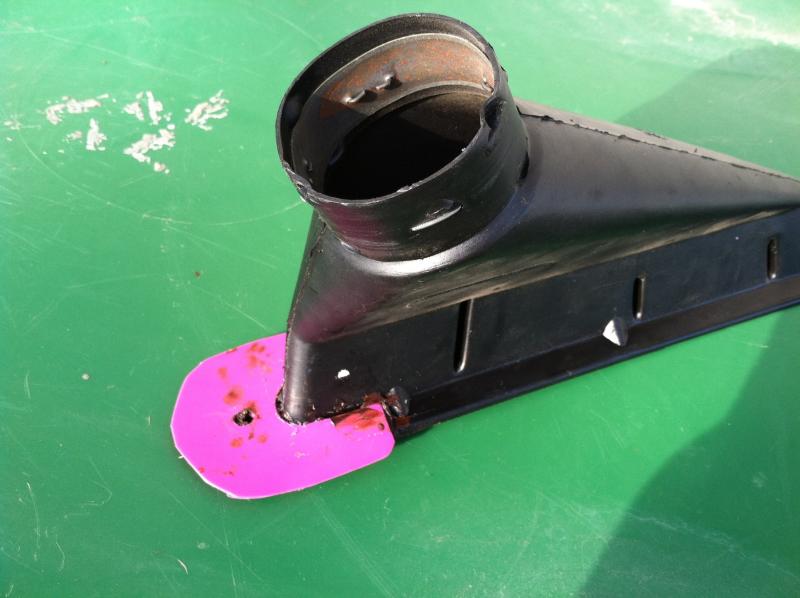

I did " fix" a defroster duct in the process 
