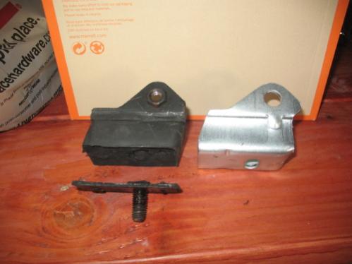

Well I notice the next day that my z bar is sloppy on the bell housing. At this point, I suspect a broken driver side motor mount. Ordered a rebuild kit from Brewers for the z bar and Moroso solid motor mounts from JEGS.

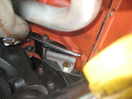

Many labor hours later, and I have the new mount in. I added a steel spacer to help me tighten the bolt next to the oil dip stick. What a long and aggravating job. I need a flexible dip stick for the header clearence. Any ideas?
