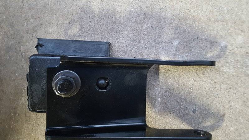

I went to brand new rubber mounts with powder coated brackets at one point.
Bent the driver's side mount.
