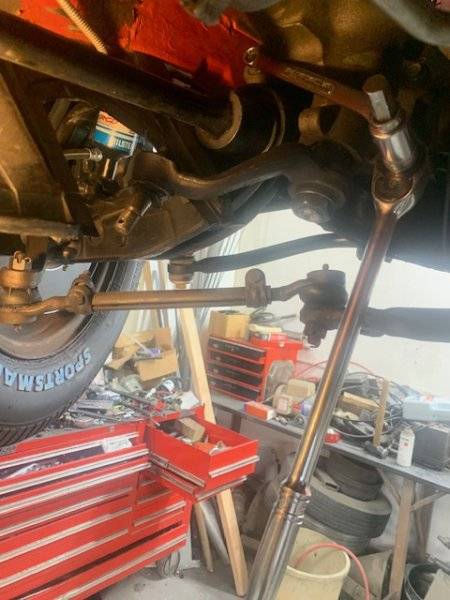

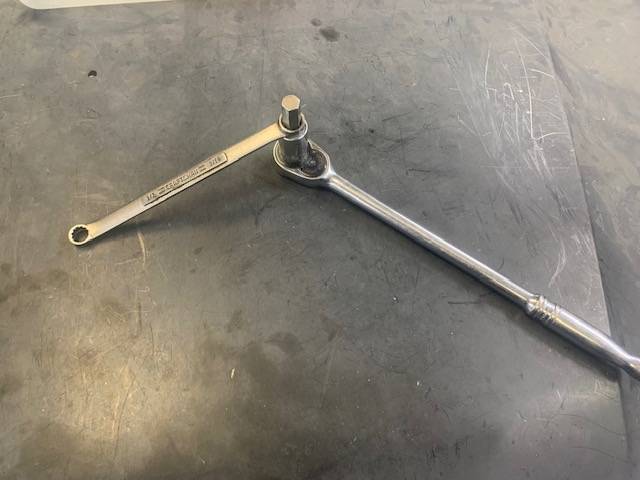

So, I'm swapping out a steering box, all three bolts are very tight, the two near the engine I used a breaker bar and they came loose.. The one close to the frame rail I couldn't get the breaker bar on with room to rotate the bolt... So I started looking at options.... And found a combination of tools that worked very well...

That single fastener/bolt/screw is in a spot where a ratchet has almost no leverage. I've struggled with them before but THIS is a novel way to remove it.
