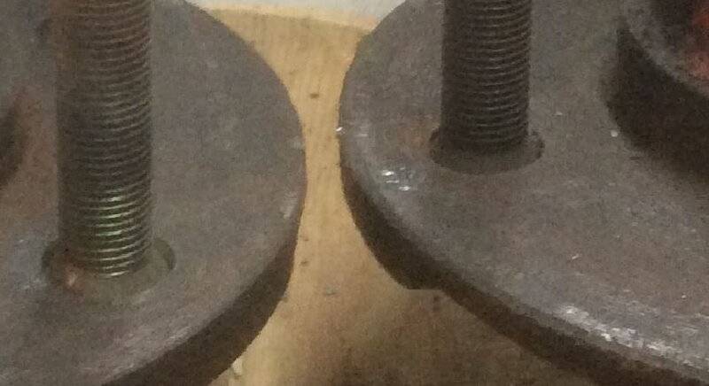

Want to sell these to funknut but after looking at pictures I noticed that there is no shoulder for swagging, threads go right to hub. If he uses them as is would it be a problem?? The drum would be held by center of hub. T
hese are 3" studs.
