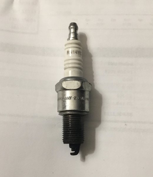

A bit aggressive cam solid lifters. Old plugs still at .35. (360) Not sure of heat range on this, I know, Champion plug.

When I was adjusting the TQ carb a long time ago the motor seemed to run best a little rich. I’ve leaned it out a little. May go more. This is that #1 plug.

I can see a Champion '14' in the pic, which is equivalent to an NGK 5. That should be hot enough in terms of heat range.
Plug looks very rich. Is the car smelly at idle? Rough idle? TQs are a great carb. The best 4bbl.

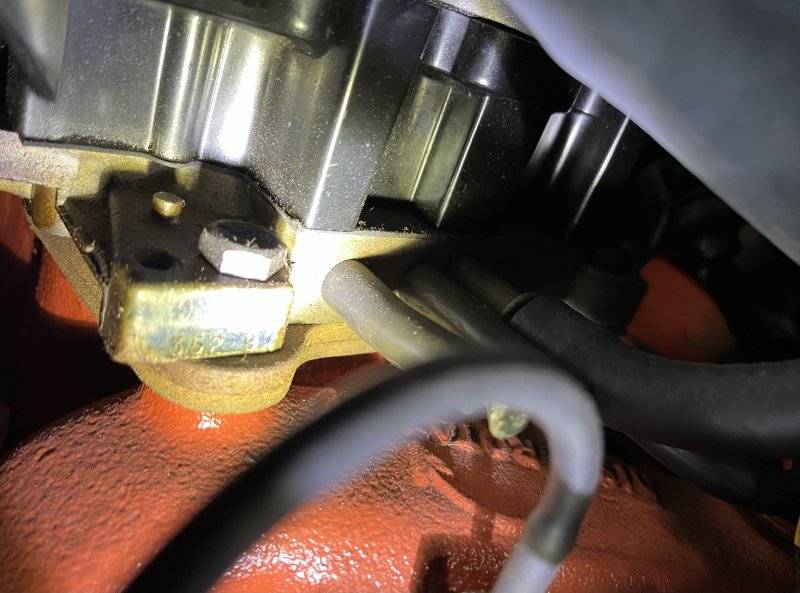

I got to thinking. Many years ago, I was talking to a neighbor about the unused “nipples” at the rear of the carb. He was saying that the large one, second from right side, went to bowl. He said “back in the day, it was common to run hose away from engine that way”. I don’t know if that was true, but I ran the hose outside. I noticed that there was a slight suction on that hose and I put an inline filter on the hose, not wanting to suck in any crud. Should this hose be left open, or what. I read somewhere about a solenoid going there.
I can see at the back of the TQ the emission hose on the driver's side.

Is the air valve dashpot on the carb? It mounts under the passenger side rear mounting bolt/stud & it's rubber hose plugs into the nipple on carb base, nearest the mounting bolt.
I do not know much about the emissions stuff on these later models.
That hose on the driver side is blocked off. Sorry, I don’t know the cam specs. I do know that the mixture screws have affect and will stall motor if I go to far in. Yes on the dash pot, (edit)
