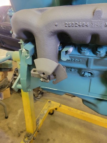

1967 Dodge Charger 383 Engine: (1) Is there a spark plug heat shield around both plugs on both sides of the engine that are next to the connection between the exhaust manifold and exhaust pipe? One person said one shield on left side and two shields on the right side. On my 1968 Newport 383 there is two shields on both sides. (2) To cover the intake manifold insulation, is there a metal cover at both ends (front and back) or just in the front? Thanks!

I know the shield (one only) answer: front! Any prize?
Mike
On the right side is the 1 two plug shield, and on the left, should be a one plug shield for #7.
The cbodys left side is different, and should have 1 two plug shield.
