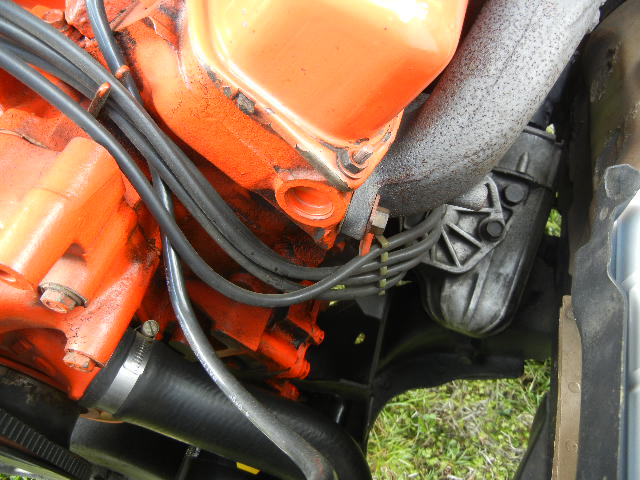

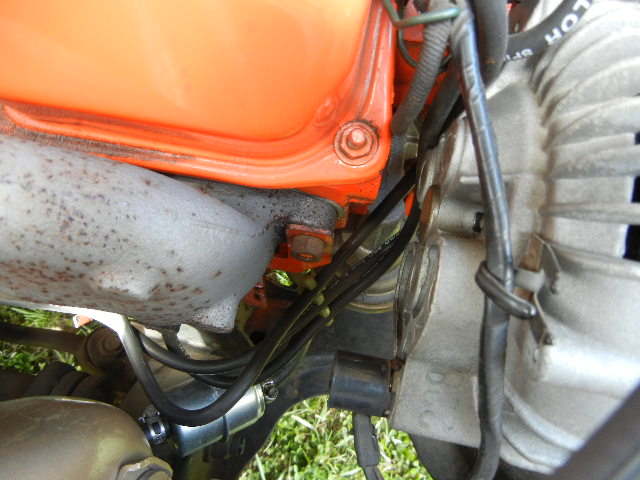

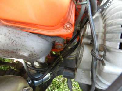

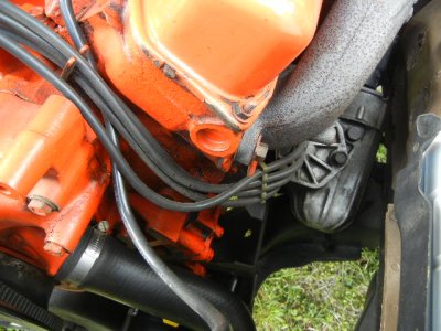

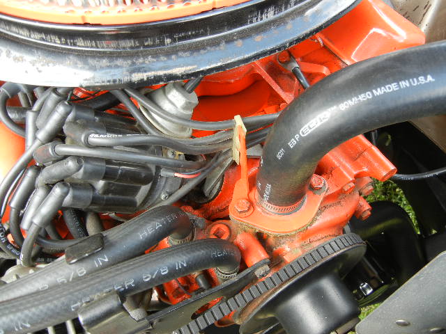

Does anybody have a good picture of where the plug wire holders go on a stock 1969 383 Roadrunner? I have 3 holders that can hold 4 wires and 2 that hold 2 wires and a couple of others.
here are some pics of a survivor '69 Road Runner I took when I added new wire holders on my car. DSCN1239.JPGDSCN1240.JPGDSCN1241.JPG
Thanks, that helps a bunch. I can see where the ones wit plastic holds go. I think the others go on a head bolt between 1 & 3 and the other between 2 & 4. Then there is a little bracket that is at a 90 deg. and has a hole on one side big enough for a head bolt and a slot on the other end bigger than a plug wire, I can't figure out where that came from. I can post pictures tomorrow.
