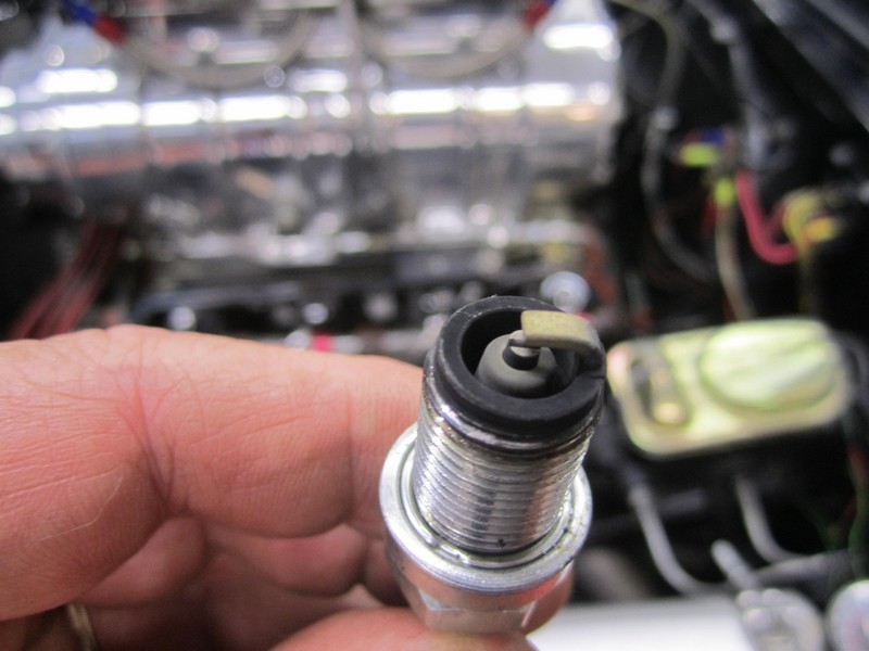

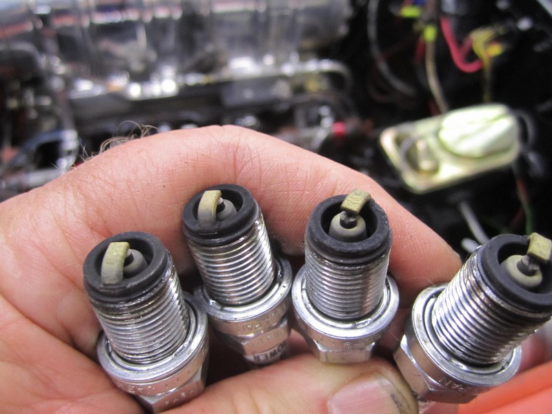

Ran Champs for years,they fouled too easy.Now using NGKs and I'm between 7s & 8s with the heat range.
Regardless of which plugs you end up using, put a little anti-sieze on the threads. Makes you next removal much easier and will prevent the threads from rusting together/stripping or galling/stripping the threads in an aluminum head. My rule of thumb, if it does not require loctite/thread sealer and is not an internal engine bolt, antisieze them. your following removals make life much easier.
NGK's. Pulled them to look and put them back in.
I always prefer a cad plated plug, ngk/bosch/champion etc, over a black oxided autolite/motorcraft/ac etc, because the black oxide finish like to contribute to helping the plugs to get stuck in the head. Regardless of which I end up using they get a little anti on them. Don't need any additional things to fix.
