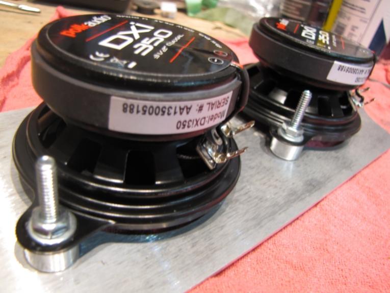

That's a good point Funship...I went with a dual speaker template and two Polk Audio 110watt speakers to replace the rotton, blown 2 watt speaker the factory had in my '69RR. Needless to say the factory AM radio will not be powering them, but still will be retained in the factory location. I did not have any problem with the radio interfering with the magnets as far as fit, but had to shield the factory tach because the magnets were pulling the needle over. Just throwing it out there.
http://www.forbbodiesonly.com/moparforum/showthread.php?15647-Dual-3-5-quot-dash-speaker-bracket

Those must be 3.5" speakers Prop? I used some 4" Kenwoods, and had to do some modifying for the heater control.
Yes sir....3.5" Pretty sure that's how Polk signify's the Model #.....Those are 350's, so 3.5". 4" would be 400 series. These were pretty snug with the heater control cables. I imagine 4" would be real close.
