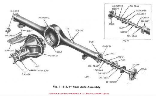

I just finished installing a slip diff in my axel housing but never noticed the adjuster on the right hand side. After reading this thread, noticed the adjuster in the drawings.

Tapered axle bearings or Green bearings? The stock tapered bearings has a thrust button between the axles and the adjuster sets the axle end play.
Before removing the axles,I usually put a dab of paint on the adjuster ring where the retaining washer was engaged.That way when you put it back together,the old adjustment should get you real close or right where you need to be for the end play adjustment.
