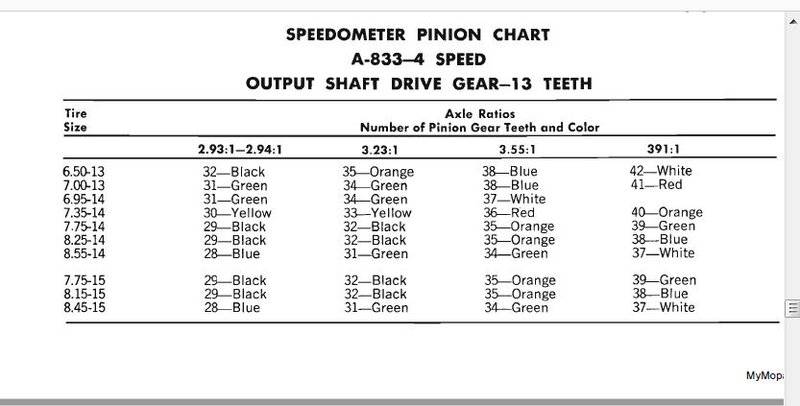

I don't know enough about these A833 transmissions, so I'm asking the question. How do I calculate or find out what size speedometer Pinion Tooth size I need to buy for my A833 transmission? I have a 67 A833 trans, 18 spline installed on my 426 Hemi with a stock Dana 60 rear end (3:54). I looked at Brewars website and see many used speed pinion gear sizes for sale but nothing new(currently out of stock). Any advise is appreciated.

You'll need tire diameter as well. There are charts on the internet. Do a little searching and you will find the.
A factory service manual has the chart that tells which tire diameter and gear ratio to use for each speedo pinion.
Too bad we all can't convert the tire size to diameter. Something that always pissed me off about the FSM.

BFG used to have a chart of tire diameter by tire size. It can likely still be found on internet.
Just googled 775 x 14 = 27.02" dia. Go to Coker tire and look up tire size and it give diameter. 4- 775 x 14 tires $1,189!!
