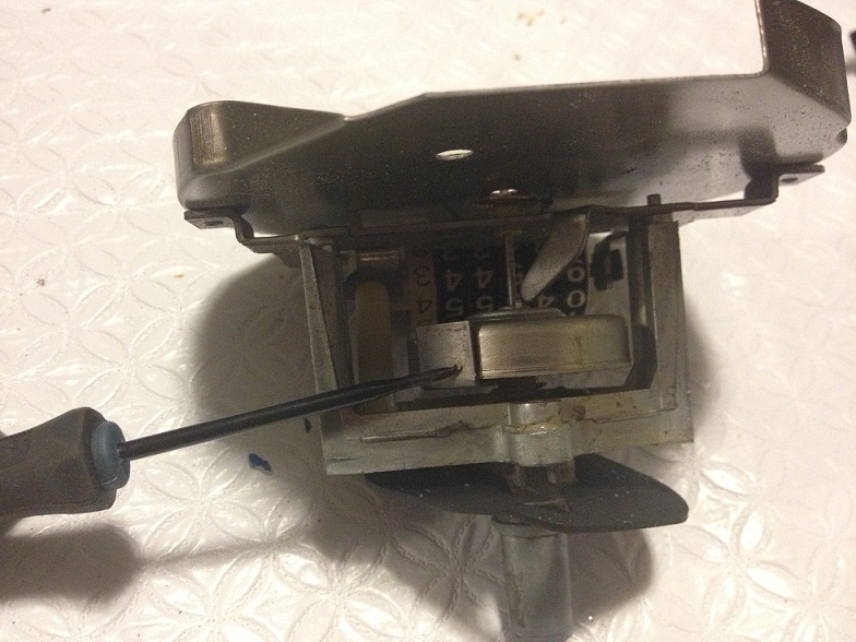

I pulled the gauge out. When i turn it manually I notice that it binds at a specific point each rotation. Also the gears that connect to the odometer are not moving at all , and I can't even turn them by hand. I think this is what is binding up the gauge.
I can't seem to remove the two gears that connect the odometer. Metal part part of the housing stops me from removing one of the gears, and the other is held in place by at tab that goes threw the gauge housing. I dont' see how I can remove it with out breaking off the tab and since I can't remove the other gear I am kinda SOL .
Maybe someone can help??
