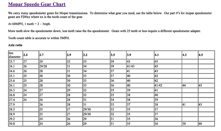

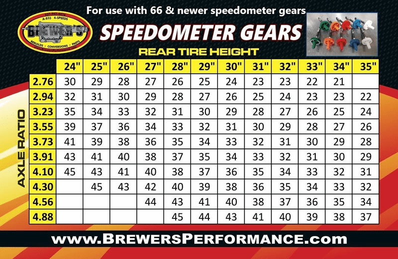

If my speedo reads too high do I get a gear with more teeth or less. Currently mine has 26 teeth. 68 Dodge Coronet 500 727 trans.
More teeth. Somewhere on this site is a chart, by tire diameter and gear ratio. I can't seem to locate mine right now.
One tooth is about 1.5 mph in my experience.
