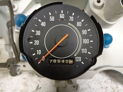

Then today on ebay I find a rallye 120 mph speedo, never saw one before. What year/model did this come on?

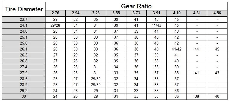

Yep, double check which speedometer gear you have in your transmission. Easy to check, just measure your rear tire diameter and look it up on this chart with your gear ratio to see how many teeth the gear should be and verify what you have.
