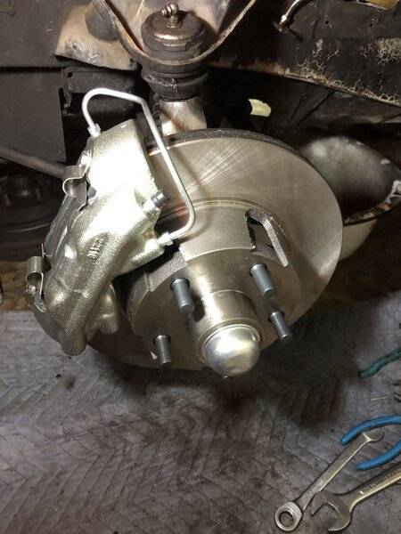

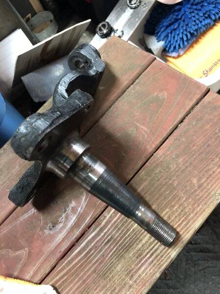

Thank you, I found that my left front spindle is bent and I need to replace it due to a disk brake conversion. I got the old one off using a large soft blow hammer with no pickle fork.
Just make sure it's a disc spindle. All the same up into the early 70's. Unless you are using drums, then a drum spindle.

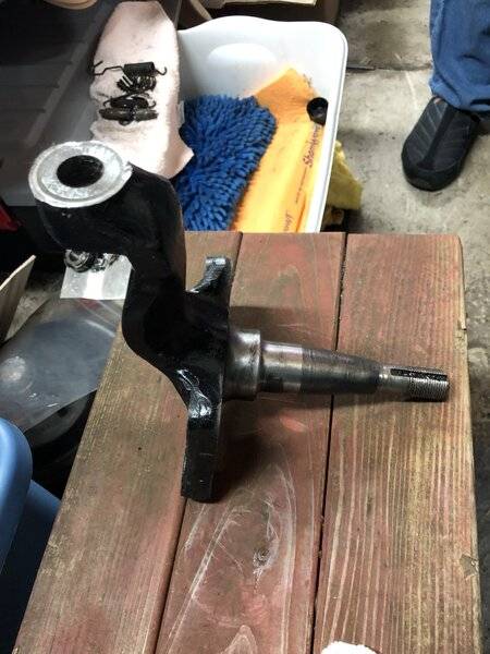

Replaced the drum spindle because the kit I bought was made to be used with the drum brake spindles. Spindle was bent downward, still can’t figure out how a spindle would end up bent downward. All together now, on to the next jobs!
