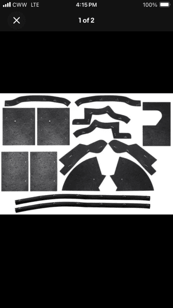

My 65 coronet sedan, AT has no, none, nada splash guards. Thought about getting these, but not sure where they go, can someone help me?
View attachment 1566281v

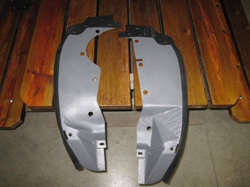

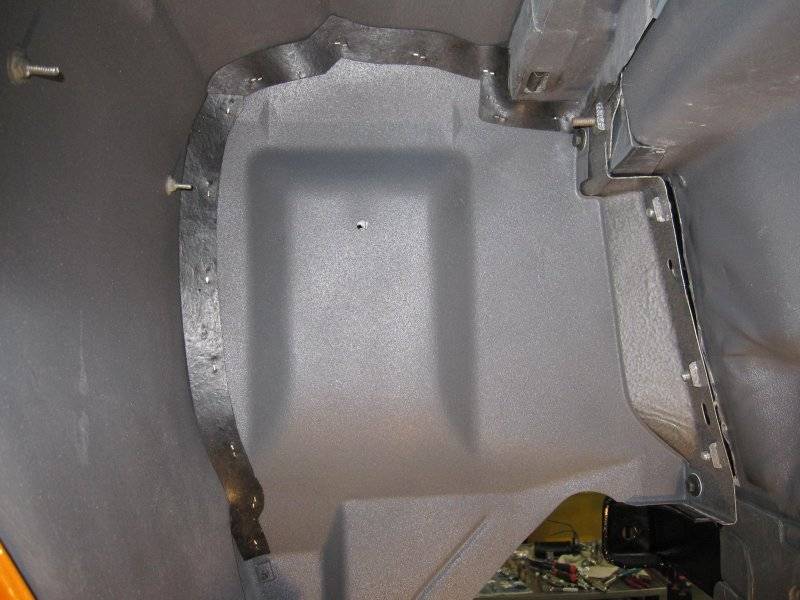

The top pair of "eyebrows and the 2 "M" shaped seals are fitted to the front splash shields.
Top right is used with a clutch equipped car.
The pair below the left "eyebrow" seal are the rear alignment cam hole covers (front covers are steel).
Arched pair cover the triangular hole where the frame rails attach to the fire wall/floor pan.
The weird pair above the arched pair and the long skinny pair seal the rear splash shields to the fenders.
The 2 rectangular seals, left of the arched pair, I can't place, right now. Someone else will know.
Note the fender edge of the seals should be curved into the tire area for proper sealing.
